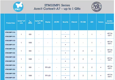

Looking at AN5478 implies that the entire line of STM32MP13x has a DCMIPP interface. However for STM32MP131 DCMIPP is not mentioned in the datasheet.
Does the STM32MP131 have a DCMIPP interface? If so, are the pins and the functionality matching that on the one on the STM32MP135?
Thanks.

Hi @daikon
AN5478 is generic for the STM32MP13x family, you should refer to datasheet or product selector to look for available features.
Only STM32MP135 has camera interface.
https://www.st.com/en/microcontrollers-microprocessors/stm32mp1-series.html
Anyway, I note that to clarify AN5478 scope in future release.
