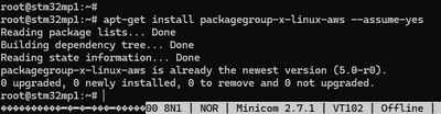

2024-05-21 1:37 AM
2024-05-21 1:56 AM
2024-05-21 2:12 AM
Yes, I want to STM32MP13 to connect to the AWS Cloud (AWS IoT Core).
2024-05-21 2:21 AM
Hello @younghan,
Thank you for your interest to the X-LINUX-AWS expansion package.
You can find the documentation entry point of this package here: https://wiki.st.com/stm32mpu/wiki/Category:X-LINUX-AWS_expansion_package
Because you have already installed the package, you can go to the configuration step: https://wiki.st.com/stm32mpu/wiki/X-LINUX-AWS_Expansion_Package#X-LINUX-AWS_Expansion_Package_software_setup
Best regards,
