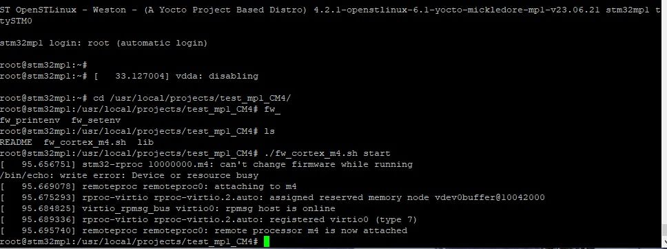

4) I tried to starting the code from linux and it works:
5) In the end I tried the rproc commands but without success.

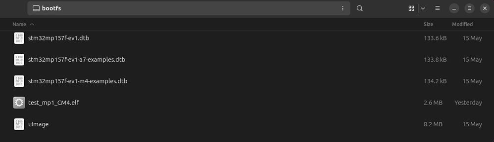

I copied the file "test_mp1_CM4.elf" in the boot partition:

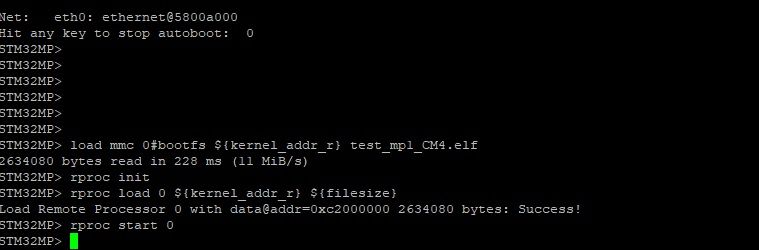

and I tried to launch the firmware:
The led blink doesn't work.
What am I doing wrong?

It might be that you need to modify the linux kernel device tree to automatically attach the remoteproc probe at boot - https://wiki.st.com/stm32mpu/wiki/How_to_start_the_coprocessor_from_the_bootloader#Linux_kernel
To elaborate: If I recreate your steps with a similar "blink" elf-file, I have the same experience as you: The LED blinks when the elf is launched from linux, but not when launched from the u-boot elf.
However, when I launch the elf-from uboot, and boot into linux, I see that the remoteproc state is set to "detatched" for the m4:
cat >/sys/class/remoteproc/remoteproc0/state detached
If I do not start the elf in uboot, the state is simply "offline".
When the state is detached, I can start the application using
echo start > /sys/class/remoteproc/remoteproc0/state cat /sys/class/remoteproc/remoteproc0/state running
and the blinking starts. This is consistent with the guide linked above, so maybe you need to recompile the devicetree.
