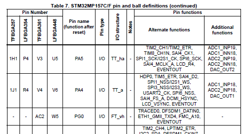

2023-05-16 5:33 AM
Please refer to product datasheet pinout to see which GPIO have ADC capabilities.
All GPIOs have analog mode (for power saving in order to disable logic driver and receiver), but this does not mean there is an ADC connected to it.
There is no way to 'read' from GPIO analog unless using ADC to acquire the analog voltage on available ADC channels on specific GPIO pins.
Regards
2023-05-16 5:59 AM
Thank you. That actually makes perfect sense. They are all analog capable, as it's just a setting to lower power. However, to read actual analog signal they must be attached to an internal ADC peripheral. The datasheet is sparse. However, the Reference Manual has quite a bit of information about GPIOs. What I don't see is an indication about what GPIO inputs might have an ADC backend. But I'm not sure what exactly I am looking for in that regard.

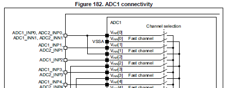

2023-05-16 6:33 AM - edited 2023-11-20 5:25 AM
I agree ADC connections are quite complex to fully master.
Best for this ADC pin choice is to use CubeMX.
You could find information in Product Reference Manual, ADC section
e.g.
together with Product Datasheet pin list, looking in additional function column
Regards.
2023-05-16 6:40 AM
Thank you. That helped me determine what I was looking for in the datasheet!
