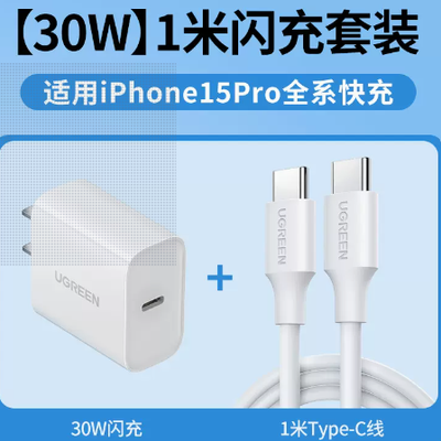

2024-06-26 8:11 AM
I bought another power cord:
The previous log is no longer printed:
Previous ADC measurements was not the one expected, retry in 20ms
* WARNING 500mA power supply detected *
* Current too low, use a 3A power supply! *
The complete log is attached "log2024.06.26.txt".
Looking forward to your reply.
Regards
