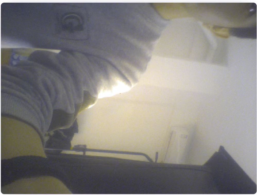

I'm working on camera integration with GC05A2 on STM32MP257. The raw image quality is acceptable, but after enabling AWB and CCM in the ISP pipeline, the output image shows severe noise (both luminance and color noise), especially in low-light conditions (<300 Lux) or shadow areas.
