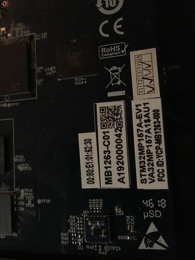

I'm not exactly sure where to find board reference number and serial number, I don't have the original packaging with me at the moment (I can get it if necessary). Hopefully this picture captures it? Thanks
2020-10-26 2:11 AM
Please check carefully that all jumpers are set to their default (according to board UserManual).
Maybe worth to try to Flash and Boot using embedded eMMC.
Sound very strange that board is partially booting, you might have a weird HW issue around the SD-Card. BootROM and first level boot are using 1-bit data, then 4-bit data is used at one point of time, which might explain that the boot is starting ok then failing.
