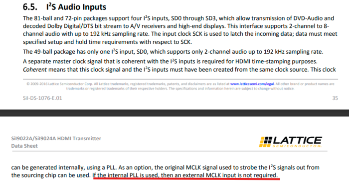

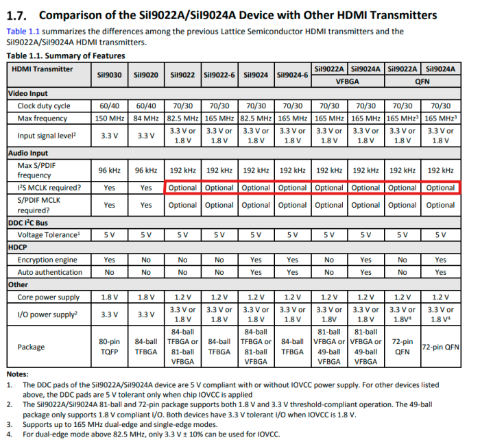

Note! What you are refering to is not the HDMI PHY.
You refering to another IC chip.
The linux kernel does not support sii9022A without MCLK.
I get these debug messages from sii902x.c https://github.com/torvalds/linux/blob/master/drivers/gpu/drm/bridge/sii902x.c because my device requries MCLK. I have not routed that track from my MCU to the PHY. So sound won't work for the moment until sii902x.c supports PLL as a clock instead of only MCLK.

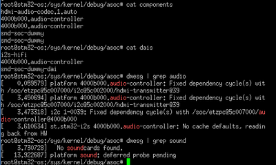

2024-10-29 1:41 PM
Hi!
I solved the problem. Now I can hear sound from my SII9022A PHY.
I did not use ASoC Graph Card, instead I used Simple Card inside Linux kernel.
I post the Linux Device Tree in case if some one in the future want to play some music through the SII9022A.
