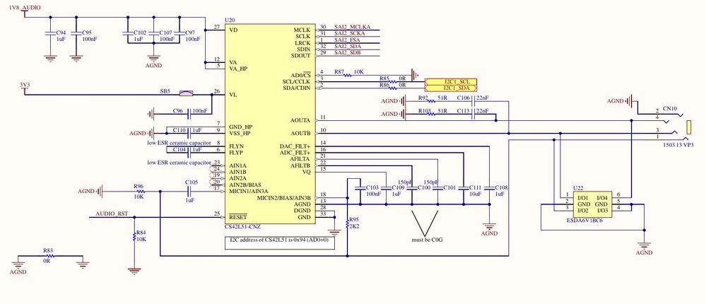

I'm buildning my own computer by using STM32MP151AAC3.
I'm going to draw lines for the HDMI connector. I have one question: Can I transfer sound via the HDMI cable? For example if I run OpenSTLinux onto the STM32MP151AAC3 processor, and then I connect the HDMI cable and I can see the screen. Will I be able to hear sound too if I surf into Youtube?

But does this mean that the ASoC Audio Graph sound card support is another card and not i2s?
Because in the Dev-board of STM32MP1 series. They contains a special old-school (imo) audio jack and a chip that are connected to i2s. Is this the "sound card" the wiki refering to? It's from STM32MP15-DISCO board.
My situation:
In my situation, I want to use the I2S bus which linux is recognizing, together with SII9022A HDMI PHY.
This question is more like a software-recommendation question, rather than a programming/configuration question.
