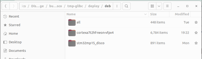

so when I viewed in my host pc for deb files in the build path
 so i changed the filename for getting from the server of host pc
echo "deb [trusted=yes] http://<IP>:8000/stm32mp15_disco /" > /etc/apt/sources.list.d/my_custom.list
 and I also saw that the cortexa7hf-neon-vfpv4 is missing in my built

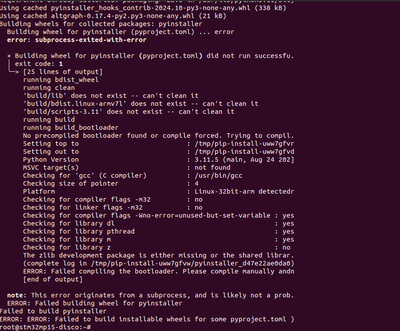

Still I went ahead try to install pyinstaller but I ran into this error
Hi @Mohanv
The error says the libz library is missing.
Try to build it if not present in your repo (bitbake zlib1) or install it with apt-get install zlib1

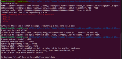

Hi @Jean-Marc B
and thank you for your quick response.
I was not able to build the zlib1 and was also not able to install it. with error
and my main concern is to install pyinstaller.
so is this zlib is needed to do that .
I have doubt when you said that to rearrange the index in above suggestion , so should we not need to flash it to the kit
Guide me step by step to get proper files so i can install pyinstaller properly and as i mentioned above message you can see that it have error with pyproject.toml time.
Hi @Mohanv
The bitbake error message shows the right recipe to be called: zlib.
So, you need to build zlib then update your package index. That would give:
$ bitbake zlib
$ bitbake package-index
Then refresh your APT configuration and install the zlib package from your ST board:
# apt-get update
# apt-get install zlib
