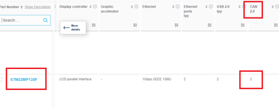

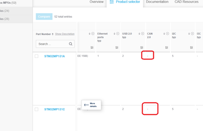

2025-01-09 3:58 AM - edited 2025-01-09 4:41 AM
Looking at STM32MP131 datasheets, there is no CAN support at all neither FDCAN nor CAN2.0.
And indeed in the product page it shows the unvailability of CAN/FDCAN on these devices:
Unlikely to STM32MP157 or STM32MP135 which have two FDCAN instances each .
Example of STM32MP135 in the product selector:
And I confirm there is an issue in the Peripheral naming it needs to be FDCAN not CAN 2.0.
Hope it's clear now.

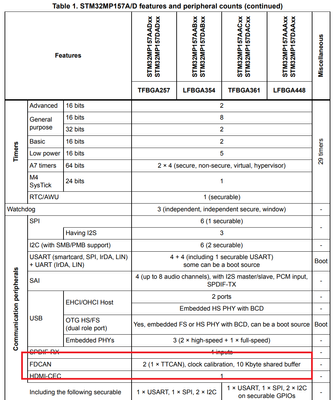

Hello @automationworld and welcome to the Community.
STM32MP157 has two FDCAN instances.
From the datasheet:
Are you sure you are looking for a MPU product not MCU?

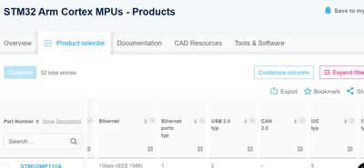

2025-01-09 3:50 AM
Thank you and really appreciated! I missed digging into the datasheet. My question came from the high level product selector at MPUs intro page doesn't explicitly show CAN FD option but only CAN 2.0.
