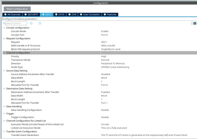

I am trying to get my ADC using DMA working in my freertos program running on the M33 core of the stm32mp257 processor. I set up ADC1 on HPDMA3 using cube MX see config below.
I am getting a few issues.

Edit: I attached the stm32mp2xx_hal_msp.c and noticed that it is generating stuff for linked list when I have my DMA channel set to standard request mode. Is that what is supposed to be generated?
