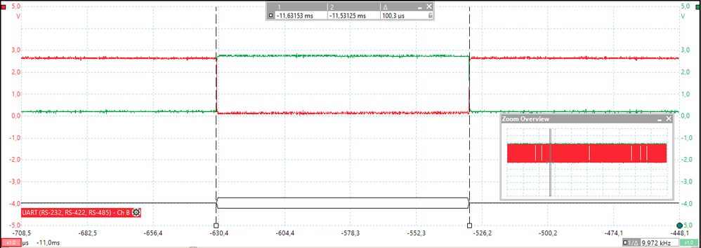

I am using UART over RS-485 on an STM32MP153AAB3.
The communication fails because the actual baudrate is off from the specified baudrate. With a specified baudrate of 9600 Bits/s, I am getting an actual baudrate of 9970 Bits/s, as you can see here (time per Bit is 100.3µs instead of 104µs):

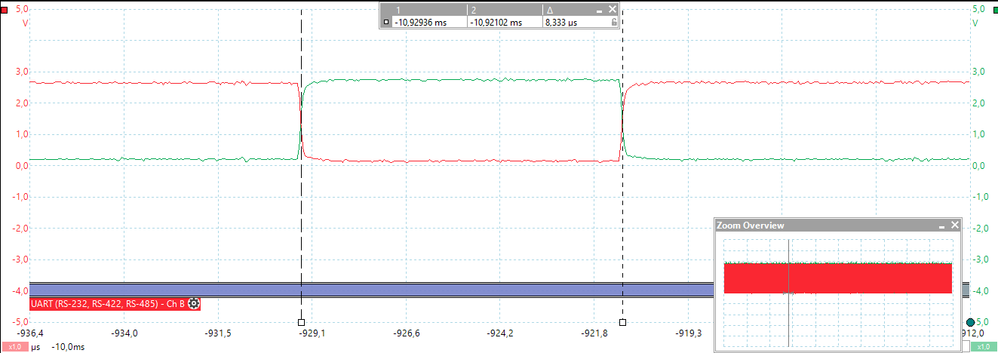

Changing the baudrate to 115200 Bits/s results in a time per Bit of 8.33µs, i. e. 120000 Bits/s:

2023-03-29 3:01 AM
The 3...4% deviation sounds like the use of HSI or CSI, both untrimmed.
Where does the 64MHz come from that you are using? PCLK1 is derived from APB1, which in turn comes from MCUSS_CK, which gets its clock from HSI, CSI, HSE or PLL3P.
