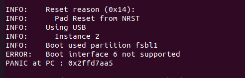

The terminal printing information is as follows.
This TF-A will start properly in EMMC.

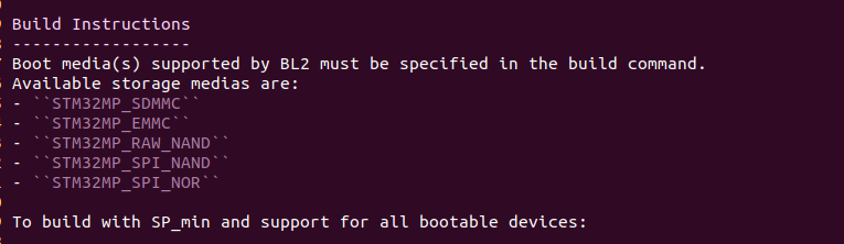

In the docs/plat/stm32mp1.rst file, I saw that USB is not supported. May I ask how to modify it so that it can be burned via USB
