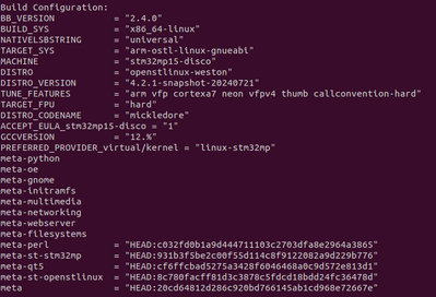

I enabled the generation of debug filesystem by adding two variables in file build-openstlinuxweston-stm32mp15-disco/conf/local.conf as shown below to use with GDB. This step is also mentioned in Yocto documentation (Link: https://docs.yoctoproject.org/dev/dev-manual/debugging.html#using-the-gdbserver-method ).
IMAGE_GEN_DEBUGFS = "1"
IMAGE_FSTYPES_DEBUGFS = "tar.bz2"

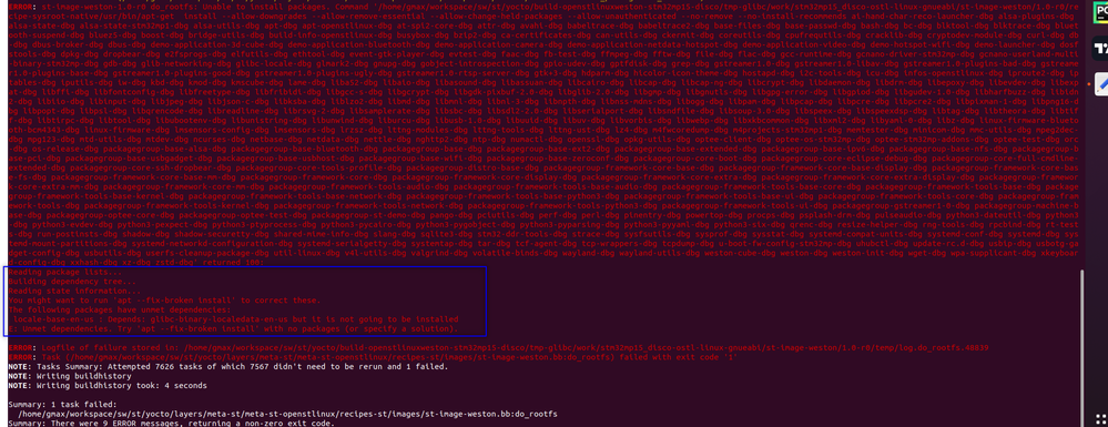

When this option is enabled I get below dependency(?) error,
Does anyone know how to fix this?
Additional information:
Target HW : STM32MP157F-DK2
Target image : st-image-weston
Thanks,
2024-07-26 9:27 PM
After few research I got to know that the problem comes from the PACKAGE_CLASSES. Changing the default PACKAGE_CLASSES in local.conf from package_deb to package_ipk fixed the issue.
# force the usage of debian package
#PACKAGE_CLASSES = "package_deb"
PACKAGE_CLASSES = "package_ipk"
