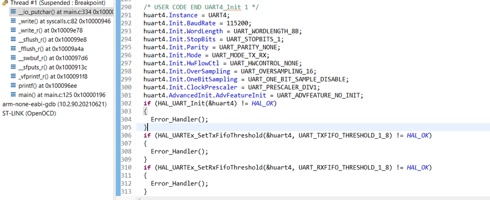

There may be another variant of this question available but I am reposting it as I couldn't get any success so far redirecting prinf messages to uart4 and viewing them on serial terminal utility.
below are the snapshots which shows I have mapped the PUTCHAR method, configured UART4 in the fw and also the serial port utility is having the same connections but I am not able to get any data on the terminal.
The code has a comment: LD Linker > Libraries > Small printf > am I missing this step? Where do I have to do this in the IDE Settings?
