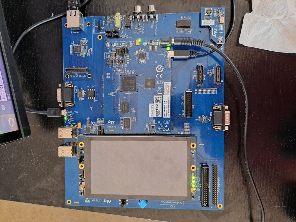

2024-08-20 6:23 PM
Let me know the location of the boot log you wish to view, I am happy to provide, I am attaching output from dmesg. Here is picture of my board, all LED seems to be functioning. Display is dark, I don't believe it is backlit.

2024-08-21 4:53 AM
Hello @pme991 ,
For sure there is a communication problem with your display, we can clearly see it thanks to following logs in your dmesg.txt :
[ 19.192278] stm32-display-dsi 5a000000.dsi: Timeout during read operation
[ 19.197685] panel-rocktech-hx8394 5a000000.dsi.0: could not read MTP ID1
As you say that you only took the Starter Package, I will check internally if we had a similar case in our test farm. If not, we can consider an HW issue with the DSI panel.
I will let you informed ASAP.
