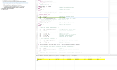

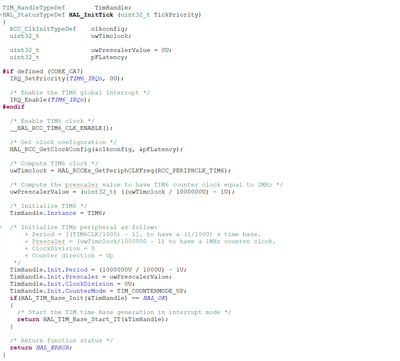

I am conducting tests related to ThreadX using the 135 DK as a reference. I'm applying ThreadX-related content through Cube and testing it, but the thread doesn't exit from tx_thread_sleep. I've compared with the demo source and even followed the steps to register Tim6, but the problem persists. Is there a solution to this issue?

I have encountered the same problem, I am very certain the demo project Tx_Thread_Creation can run, but the THREADX I created with STM32CUBEMX cannot be scheduled properly.Please refer to this link for specific details:
https://community.st.com/t5/stm32-mpus-products/stm32mp135-threadx-not-scheduled-issues/td-p/798760
