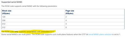

not sure it is the root cause of bad block, but only SPI-NAND with embedded ECC are supported on STM32MP1 platforms (i.e. data are always considered as error free and TF-A and uBoot must be set accordingly).
https://wiki.st.com/stm32mpu/wiki/STM32_MPU_ROM_code_overview#Boot_from_parallel_--serial_NAND
Here, bad block might come from communication issue with the SPI NAND (HW issue, too high frequency, etc...)
