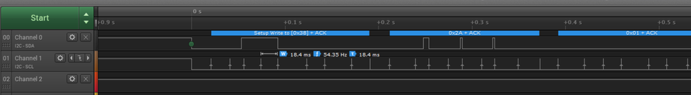

In my device tree, we config 400KHz, but on scope we see only ~ 50Hz, and the clock seems weird. Anyone know why?

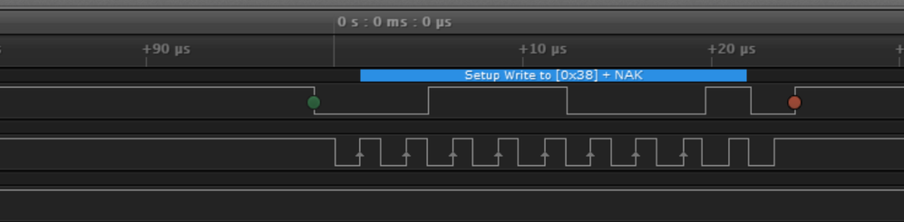

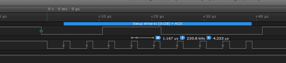

2023-05-03 7:49 AM - edited 2023-11-20 6:40 AM
Hi, Thanks Erwan,
We use custom board, MP151AAC3 MCU.
We did a bit more investigation and found that 'drive-open-drain' causes this issue. When we temporary remove this line in device tree see that the clock is 400KHz as well.
But when we remove drive-open-drain then I2c transaction failed, but the clock on scop looks correctly.
Do you have any idea why when add drive-open-drain the clock become weird?
