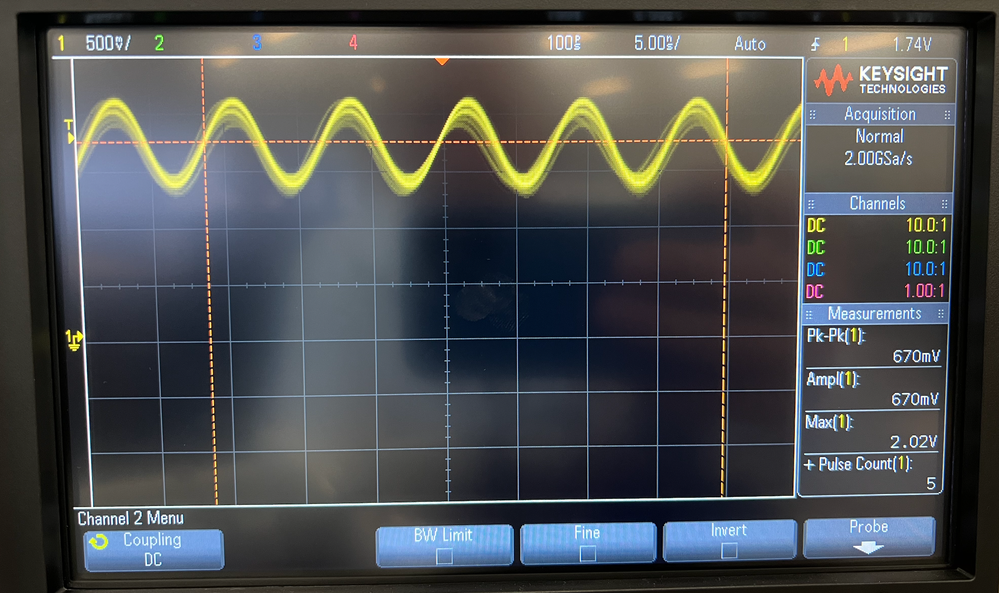

In addition, when I probe the ANA1 (Arduino Pin A3) with nothing plugged in, I get a sine wave that sits offset at ~3v and has a peak to peak voltage of about 800mV and 128MHz frequency. See pic below.
It's also notable that there is no "DMA Continuous Requests" option in Parameter Settings which I understand I need to set to Enabled.

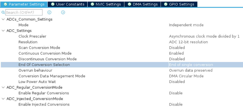

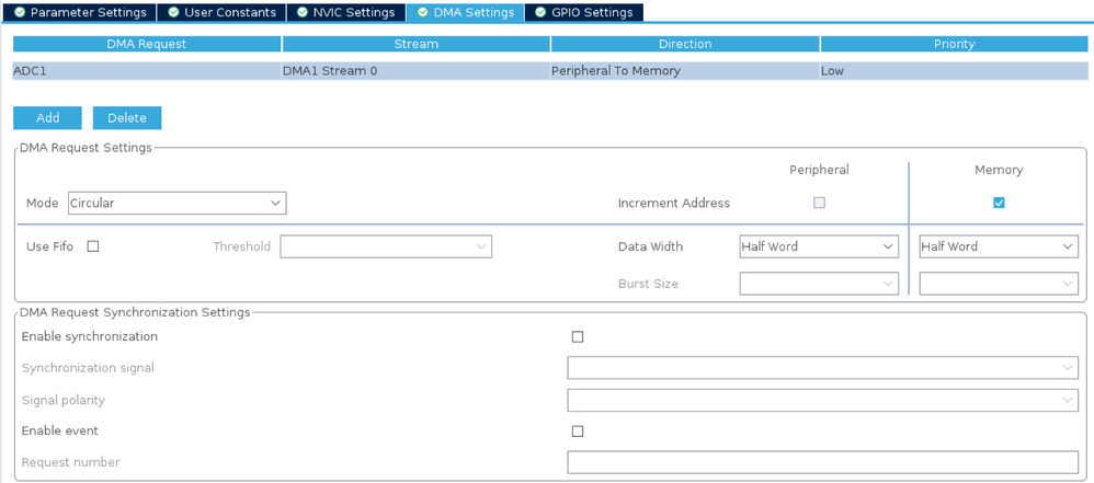

Well I finally found settings and code that worked. Not really sure what I did, but these are my configs for anyone else who's looking to do this.
