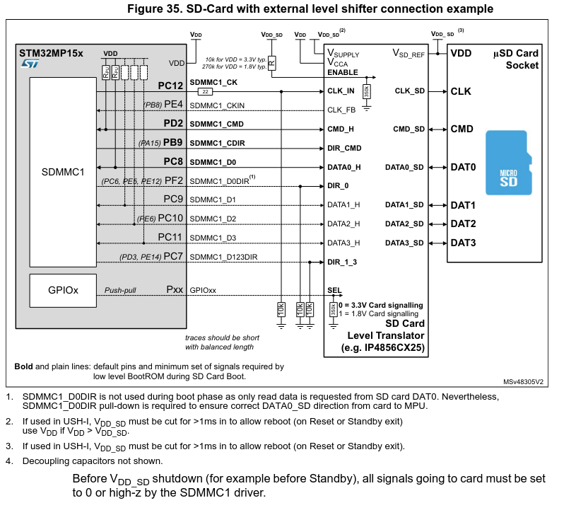

I do see some minor differences between our board and the dev board (STM32MP157C-DK2), the dev board has pull-ups on all of the lines while my board has a pull-up on D3 only and pull-downs on CLK, CMD and D0.
There is no additional hardware between the STM32MP1 and the SD card and the card is getting 3.3V. There is also a 10uF cap on the VDD and VSS pins.

pull-down will ruin weak internal pull-ups (40K) and likely create trouble. Please refer to AN5031.

Thank you for your help, it was indeed the pull-downs that were causing the problem. When I removed them it booted to TF-A. I did notice that the pull-downs are present when using a level shifter so I think there was some confusion about that: 0693W00000Y7Ks8QAF.pngWe are planning on changing the oscillator to a 24MHz (and to tie the OSC_OUT pin to ground like the dev board) based on this conversation, thank you for your advice. We were planning on using the USB boot but rather the UART boot would this cause an issue?
