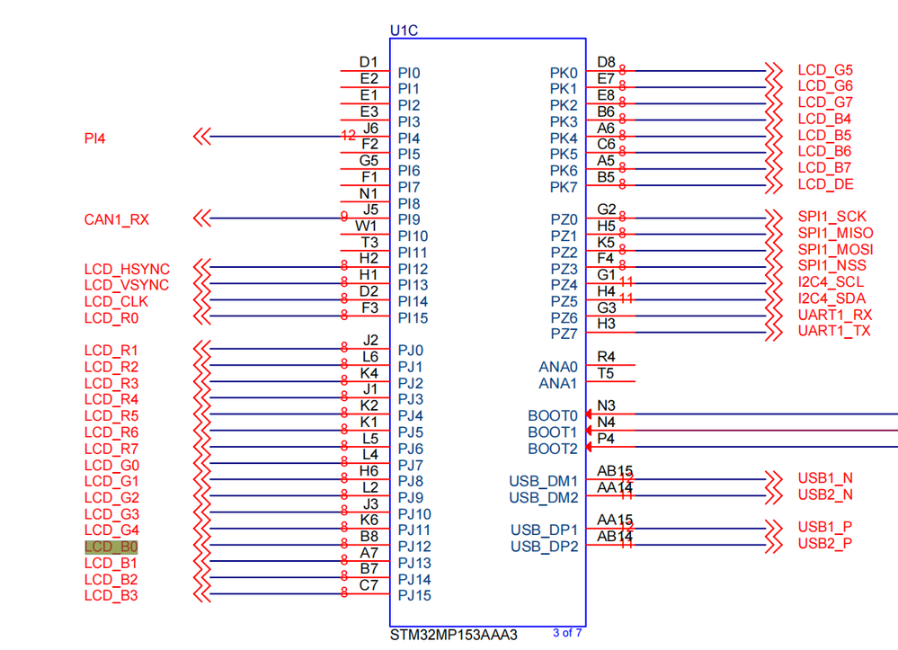

This is my schematic diagram

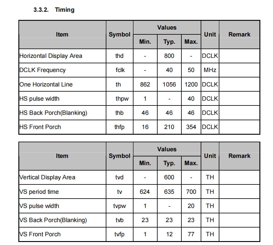

This is the timing of the LCD

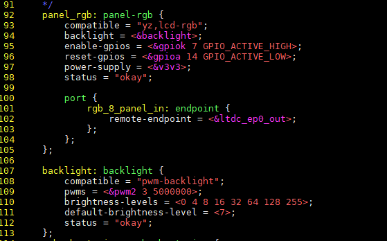

This is the LCD device tree

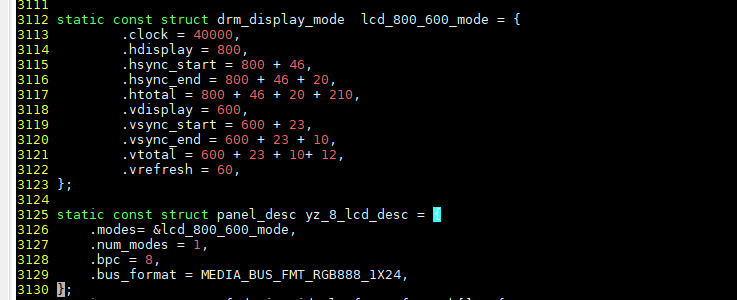

This is some panel-simple driver code

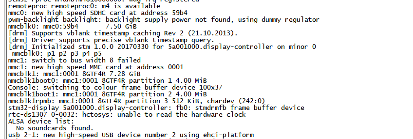

Here are some boot logs

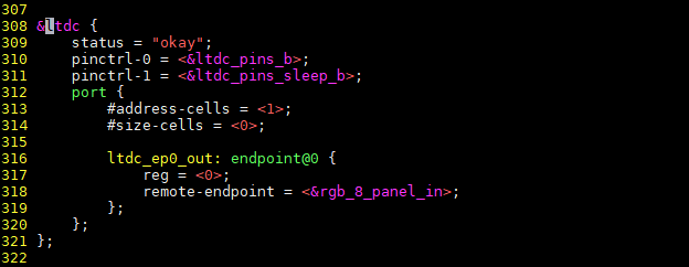

2023-03-27 6:13 PM
i have solved it.
The ltdc node has a problem:
<dc {
pinctrl-names = "default", "sleep";
status = "okay";
pinctrl-0 = <<dc_pins_b>;
pinctrl-1 = <<dc_pins_sleep_b>;
port {
#address-cells = <1>;
#size-cells = <0>;
ltdc_ep0_out: endpoint@0 {
reg = <0>;
remote-endpoint = <&rgb_8_panel_in>;
