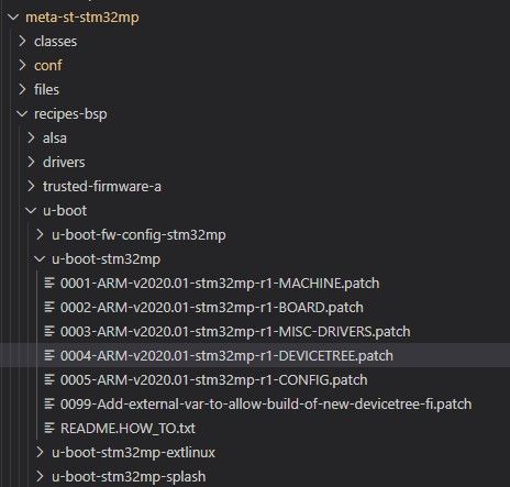

no, i see only the source files tat.gz . not the patch .
this wat i have in my Yocto layers:
do i need to update the layers from git source?
