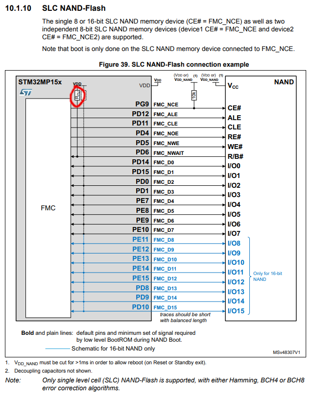

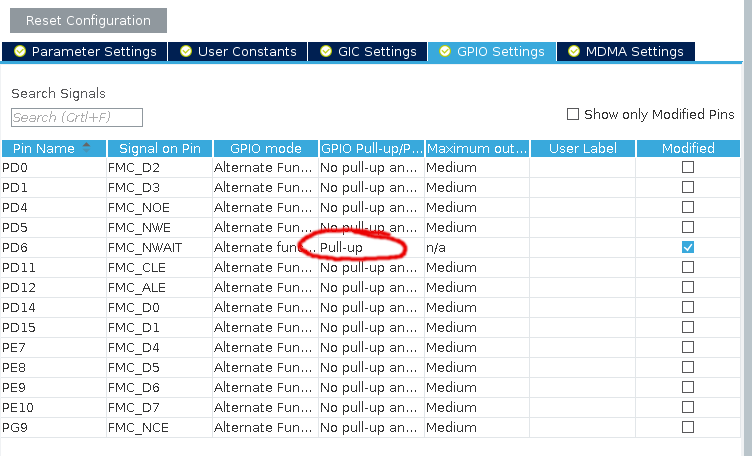

Well, after much debugging and comparing DT source files with other boards, we have found the problem. And it was quite a silly problem.
The default pin config from CubeMX does not enable the internal pull-up resistor on the FMC_NWAIT pin. In the getting started guide section 10.1.10 it's hinted at:
So a heads up: Make sure you enable this option:
Or set bias-pull-up; in the DT source:
