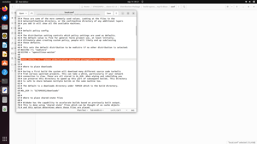

2024-08-14 3:41 AM - edited 2024-08-15 4:04 AM
I write in the right syntax when writing local conf like in the last picture.
When I build the distribution package, everything works fine, and the image flashes to the board without any issues. However, after I add the line
IMAGE_INSTALL += "qtbase qtdeclarative qtwayland qtimageformats qtmultimedia"
to the local.conf file and rebuild the st-image-weston, the number of files in the build drops from around 8000 to 5000. Although the build process doesn't throw any errors, when I flash the board with this image, it becomes stuck on the boot screen, and no commands, not even ls, work. Why could this be happening?
Instead of adding them in IMAGE_INSTALL += should ı do something else to add them to my image ?
The reason why I am trying to this is that I just want to learn how add my example qt application to my board (with adding to my image with my own layer without licensing ) .
2024-08-14 5:10 AM
@nesnes ,
Just by looking at your issue like that, I do not have a lot of idea.
What is sure is that the "_append" will do absolutely nothing.
Maybe try to add a space after your qtmultimedia " in your IMAGE_INSTALL line. Yocto will just concatenate the variable and so maybe something is going wrong, but I am not sure about that.
If it does not correct anything, I advice you to restart from scratch, with the default Distribution Package we provide that works, then step by step add your part inside and see what provoke the bad situation.
Kind regards,
Erwan.
