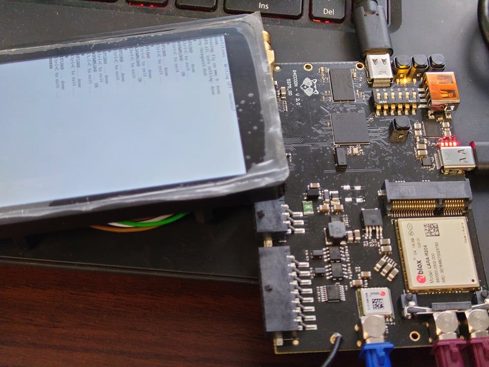

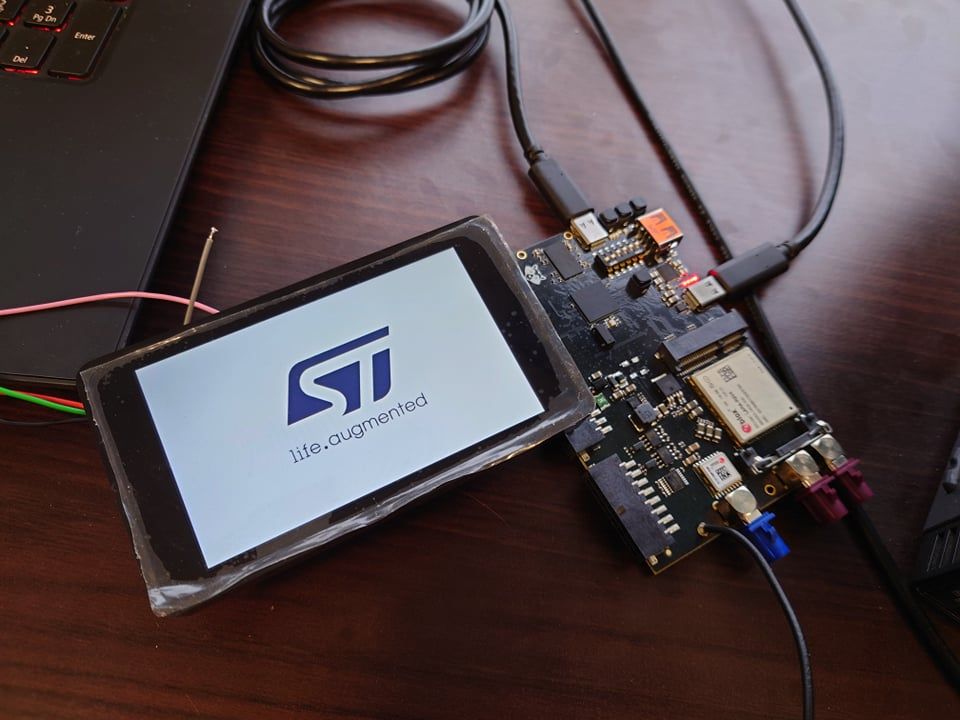

I am using MB1407C (stm32mp157x-DK2 extension board with touch-screen) connected to my custom board. When board is booting I am getting the "ST life.augmented" screen on the U-boot and black screen when kernels starts. Also I am getting the telnet commands when I am updating the flashlayout using the CubeMxFlashLoader - so my guess is the DSI connection is working, but why do i get the black screen instead of the Wayland Weston desktop- that is shown when stm32mp157x-DK2 loads up the OS? What am i missing? What is other way to test the DSI connections?

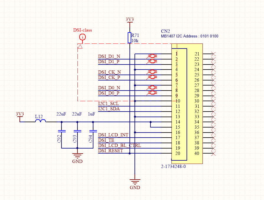

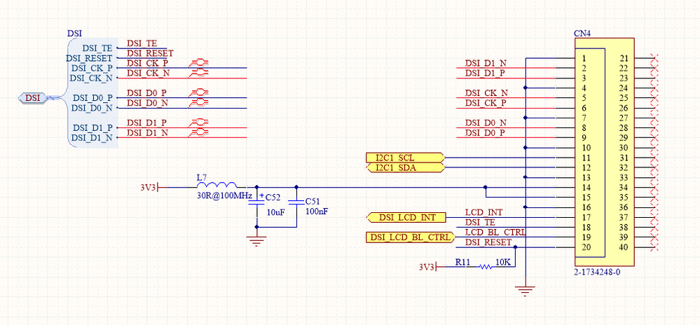

2022-01-10 6:38 AM
TOP - eval-board schematics
BOT - my custom board shematics
2022-01-10 8:45 AM
>>or issue is on SW...
That you successfully get any image displayed suggests its not a HW connectivity problem.
Start screen suggest that has all the clocking and timing in order for that part (u-Boot ?)
2022-01-11 5:00 AM
Yep it works in U-Boot and goes dark as soon as it starts up kernel, my hunch tells that it is SW too. I will try a few more things and post update :)
