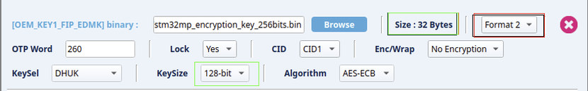

I am following the "How to deploy SSP using a step-by-step approach". I am working on "3.1.2.2. Secret file content for STM32MP2 series". The target MPU is STM32MP257F. I have some questions as below:
1. How do I know whether to choose "Format 1" or "Format 2"?
2. I selected the binary file as FIP-EDMK, which is 256-bit but the KeySize shows 128-bit and it won't let me select 256-bit again. Is this acceptable?

Hello @ThinhNguyen,
According to the STM32 Trusted Package Creator user manual, it states:
"Select the endianness format of the binary, Format 1, or Format 2. (Format 1 is fixed for word item)." Since you’re working with a binary, you should select Format 2.
For the second question, you need to change the Enc/Wrap option to either Encryption or Wrapping to access the KeySize option and set it to 256-bit.

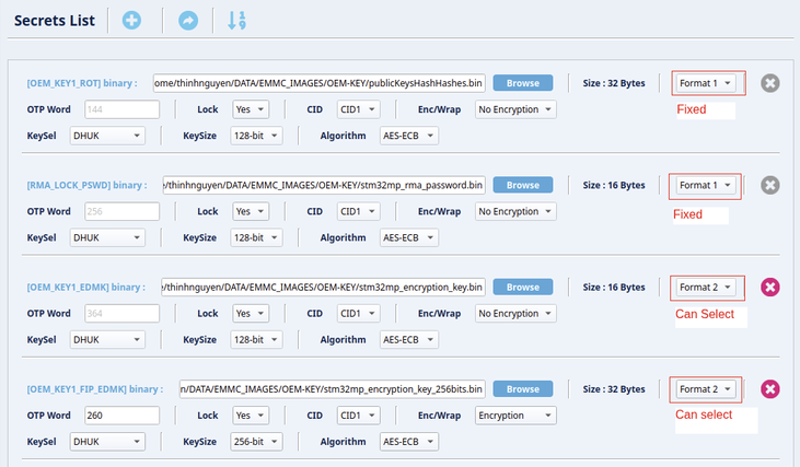

Hi @Zakaria1 ,
I read UM2238 but didn't see much mention about when to use format 1 and when to use format 2. As you said, when using binary files, you should choose format 2, so why are OEM_KEY1_ROOT and RMA_LOCK_PSWD also binary files but it requires choosing format 1.

Hi @ThinhNguyen,
Sorry, I misunderstood. In fact, for all word items, the format is fixed as Format 1. For binary items, there is a choice, but for specific keys, I believe the tool enforces the format to avoid selecting an incorrect one. The format refers to the endianness used for writing keys to the OTPs. Here’s an example from UM2238:
Endianness given in the specification for format: Keys are represented as a string of bytes
to be stored in consecutive OTP words. For example, a 64-bit key
(0xAABBCCDDEEFF5566) is stored in two consecutive OTP words, KEY0 and KEY1. A
key is stored in OTP words using one of the following formats:
• Format 1: KEY0 = 0xAABBCCDD, KEY1 = 0xEEFF5566
• Format 2: KEY0 = 0xDDCCBBAA, KEY1 = 0x6655FFEE

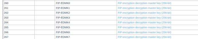

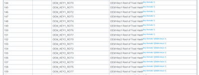

Please refer to this wiki page for the STM32MP23-25 OTP mapping to determine which format to use.
STM32MP23-25 OTP mapping - stm32mpu
Here’s a screenshot from the wiki showing that OEM_KEY1_ROT and OEM_KEY2_ROT must be in Format 1:

Hi @Zakaria1,
I looked through it, but unfortunately it doesn't mention anything about the FIP-EDMK format. You can see the image I pasted below.
Click to the link it let me to the intruction to enable secure boot. There is no information about FIP-EDMK format type too.
