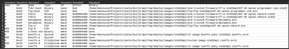

for flashing my STM32MP135F-DK board I am using STM_Programmer_CLI with my .tsv file. Example command and my tsv file:
sudo ./STM32_Programmer_CLI -c port=usb1 -w path/to/my.tsvIs there a way to explicitly set partitions UUID for rootfs-a and rootfs-b during flashing?
I've noticed that when I name a partition with rootfs then it gets UUID of e91c4e10-16e6-4c0e-bd0e-77becf4a3582, as described in the wiki . But when having rootfs-a and rootfs-b, then those partitions get some other UUID, and the boot stops because rootfs UUID is not e91c4e10-16e6-4c0e-bd0e-77becf4a3582.
I need the rootfs-a and rootfs-b UUIDs to be constant, to manage FW upgrades.
