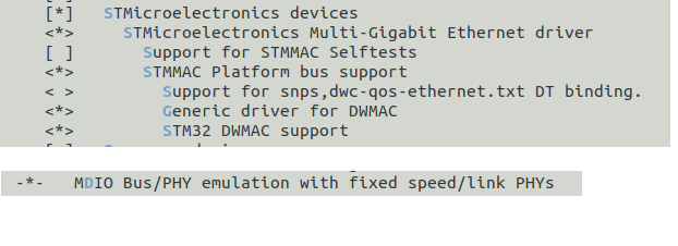

I used the the following Ethernet and PHY-Drivers in menuconfig.:
