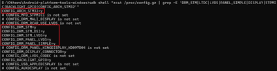

2025-06-25 6:25 PM
Hi Philippe,
I have checked dmesg log, I cannot see any message about lvds driver.
But I check my .config, the lvds driver has built in.
Thanks.
