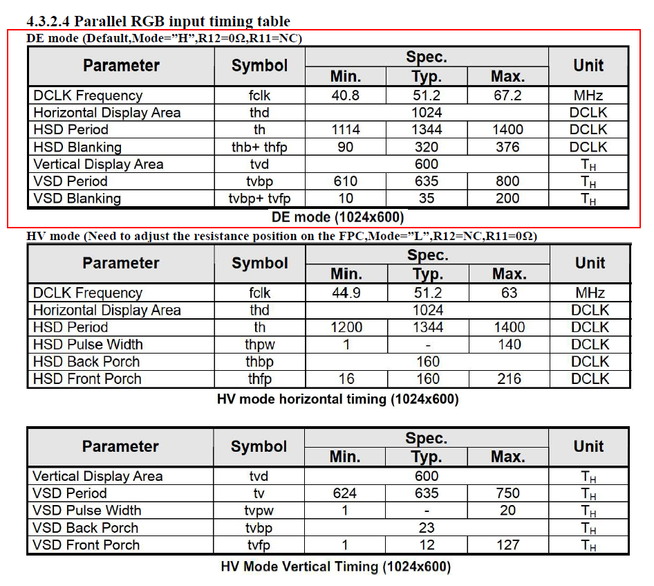

2023-05-26 12:56 AM - edited 2023-11-20 4:44 AM
Hello @erwan SZYMANSKI
Thank you for your answer and useful suggestions.
I found the sintax problem. In the ".patch" file there was a semi colon instead a comma. Now the build work fine.
Regard to display timings, in my case the display works in "DE mode". If I well understood in this working mode the HSINK e VSINK signals are internally generated by the display, is this correct? If this is correct, I don't know if the HSINK and VSINK signals have to be managed by the LCD controller or have to be set as I/O pins.
Regard to hfront-pork, hback-pork, vfront-pork, vback-pork timings value, the display datasheet doesn't indicate any value for this timings if the "DE mode" is set (see image below) so I set them to 0.

2023-06-21 12:41 AM
Hello @Erwan SZYMANSKI
Regard to my own display (JENSON model JT60396-01) customization, I want to try your suggestion number 3), that is, modify the panel-simple.c driver.
If I have understood correctly, in the panel-simple.c driver I have to do the following:
is it right?
What is the difference between drm_display_mode structure and display_timing structure? Which one to use? Supposing to choice the drm_display_mode structure, in panel-simple.c driver I added the following two structures

2023-06-21 11:50 PM
This is the panel-simple.c patch that I created
