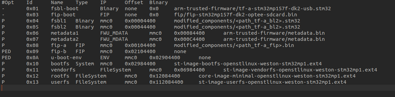

Flash Layout TSV Modifications:
I updated the TSV file to allocate a larger space for the FIP. Below is the relevant excerpt:

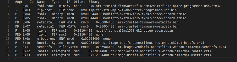

Flash Layout Modification:
Modified the tsv file to include the new TF-A and FIP files:
