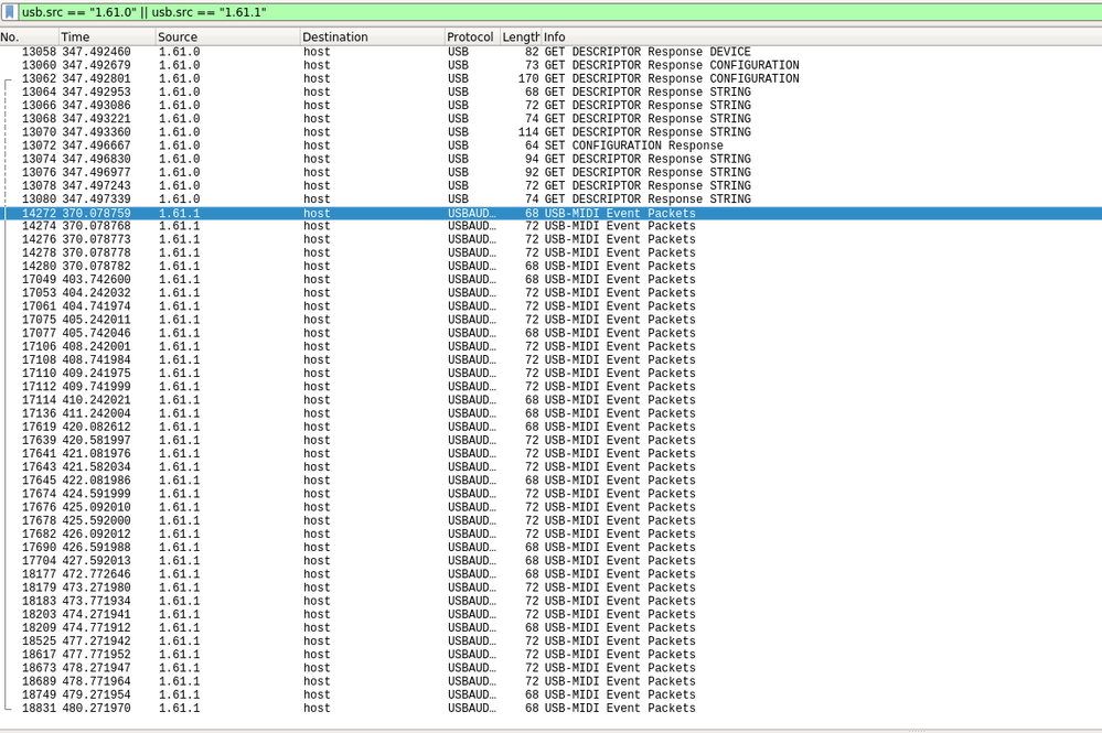

The issue is that every few minutes the host stops sending and receiving messages. I tried multiple cables and hosts and the result is that midi data will stop arriving to the host and the MP1 in the same time, after a couple of minutes. If I reset the usb cable or stop and start the usb gadget data will flow again for a similar period of time.
In order to debug this issue I used usbmon on the MP1 and wireshark on a host Mac. On the host mac I could see that when the driver freezes it receives a URB with an unknown request and then a URB with an abort request. After these two messages no midi messages can go in or out but the device is still seen as a connected usb-midi device on the host.
Trying to understand why this happens I looked at f_midi.c. There I could see that an abort URB is send when hardware forces ep reset.
/* this endpoint is normally active while we're configured */
	case -ECONNABORTED:	/* hardware forced ep reset */
	case -ECONNRESET:	/* request dequeued */
	case -ESHUTDOWN:	/* disconnect from host */
At this point I am looking for ways to debug why the hardware forces ep reset and when but I can not find a way to debug this. Any ideas or points will be highly appreciated.

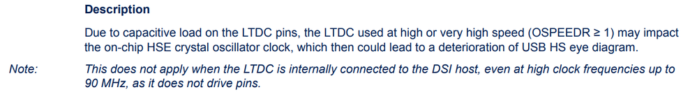

Regarding the investigation of your case, the experts showed me this errata:
https://www.st.com/resource/en/errata_sheet/es0438-stm32mp151x3x7x-device-errata-stmicroelectronics.pdf
Chapter 2.3.3
For testing purpose only, we will set your default MPU Frequency to 650MHz instead of 800Mhz and your VDD_CORE to 1.2V instead of 1.5V.
For doing that, please edit your file "stm32mp15xd.dtsi" (I know it's a dtsi file) in TF-A/ U-Boot / Linux and change the &cpu0_opp_table to:
&cpu0_opp_table {
		opp-650000000 {
			opp-hz = /bits/ 64 <650000000>;
			opp-microvolt = <1200000>;
			opp-supported-hw = <0x1>;
More information on this manipulation is available on the wiki: https://wiki.st.com/stm32mpu/wiki/How_to_change_the_CPU_frequency#OPP_table
If you correctly made the change and populated your sdcard with the new binaries, you must see that the MPU Frequency of Uboot is now 650MHz:

Then I moved to the second suggestion. The note in the errata looked to match the issue. I builded a new image based on
this wiki. After applying the patches in every step
for p in $(ls -1 ../../sources/arm-ostl-linux-gnueabi/linux-stm32mp-*/*.patch); do patch -p1 < $p; done
I modified the equivalent "stm32mp15xd.dtsi" as per your suggestion. I did this for steps 5 and 6 of the wiki which included linux / tfa / u-boot. Then I flashed the new FIP_artifacts with Cube Programmer. My boot log looked very similar to yours and after boot I verified the new CPU clock as below.

First, using wireshark to monitor messages, I pinged the USB interface activated on the board in loop (without HDMI connected) and the ping works well. If I stop the usb-gadget on the board, the ping is blocked (so the activity looks OK for now).
Now I have connected an HDMI screen to be it in the same situation that produces troubles from your side, but the communication looks not interrupted after 10 minutes. Could you explain how do you test your setup exactly (in term of communication), just to help me reproducing the bug ? Or maybe this situation is already supposed to make my usb-gadget down ?

Well I think I have something very close to your setup right now. Find below my Wireshark packet when we can identify USB packet when I plug to the USB-midi gadget, and then the MIDI packets that pass through when I want to play my midi piano file.
0693W00000Lx6zqQAB.pngOn board side, I plugged an HDMI monitor, quite standard, to make some HDMI activity. Should it be enough to replicate ? Do you need to have some screen activity to make it crash ?

The wireshark screenshot looks identical to mine. On my setup I use the weston extended image for DK1. The only screen activity is the desktop background and a weston terminal.
