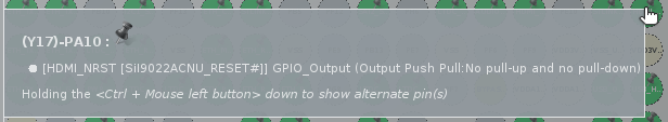

UPDATE: After a bit of research I found out that in the default STM32MP157D-DK2 IOC file there is a warning when enabling USB_OTG high speed. It seems that the pin AP10 is assigned to both USB ID and HDMI_NRSET. I tested the USB gadget implementation with the HDMI disconnected and indeed works as intended. From a short research I was not able to figure out if there is a way to avoid the pin conflict by assigning a different pin to either USB or HDMI or changing the OTG configuration. Any ideas or directions will be really helpful.

Since you are talking about "STM32MP157D-DK2" and that this board doesn't exist, I think your board is a STM32MP157D-DK1 right?
When you have a pin assignment issue, there is most of the time two possibilities to find the pin that is doing the same thing than the one is conflict:
CubeMX
By using CubeMx you can see the alternative pin by pressint ctrl + left click on the pin function:
Documentation
You can check the datasheet DS12505 v5.0 from page 65:
https://www.st.com/resource/en/datasheet/stm32mp157c.pdf
Unfortunately, you will see that USB_OTG_HS_ID is only available on PA10 (page 80):
And by looking at the User Manual of the Discovery board, UM2534 rev 1.0 page 21:
0693W00000KZyjQQAT.pngPA10 is connected to HDMI_NRST.
So you can't use the PA10 PIN for the two configurations at the same time if you are using the Discovery board.
If you create your own board, you will not have this conflict.

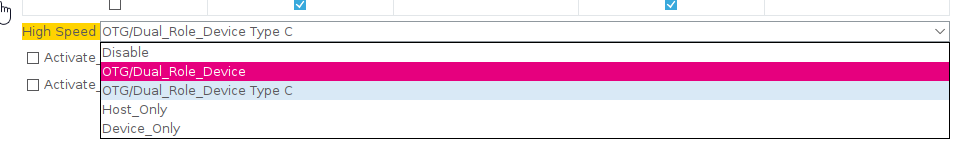

Regarding the "solution", CubeMx warns you that this PIN conflict is only a problem if you want to use OTG in dual role device, in host and device at the same time.
I tried multiple cables and hosts and the result is that midi data will stop arriving to the host and the MP1
If I understand correctly your setup, you don't need to be at the same time the host and the device in your example, right?
In this case, you can select "Device_Only" in CubeMx and you will not need the PA10 pin.
The PA10 pin is needed for the DT configuration example 3.3.1 and 3.3.2 of the wiki, but not for the 3.3.3 DT configuration example as high speed OTG, with Type-C connector
