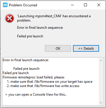

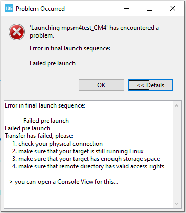

I'm using a custom buildroot build (2021.11) with linux 5.15.13, on the stm32mp157f-ev1 board.
I can load an .elf M4 firmware into the M4 core and start it, using /sys/class/remoteproc/remoteproc0
However, I can't use the debugging feature of STM32CubeIDE. I get an error in "final launch sequence".
It works fine when I'm running the standard ST linux distribution however.
Does anybody know, what is required for CubeIDE debugging to work on the M4 core in production mode?

Hi @MSven.2 ,
CubeIDE rely on some network service such as ssh, ifconfig and sftp server to load the .elf on target.
Since you are using a more recent / non validated version than the one certified by ST you may encounter few issues around this.
eg could you please display what give ifconfig on your target ?
Olivier

Thanks for your help!
ssh is on the target, and scp, but not sftp.

2022-02-08 2:32 AM
Hi @Community member ,
Thanks, I got a bit further now.
I included sftp server in my target build, and now CubeIDE actually transfers the .elf file to the target, in /usr/local/projects/my_project_name.
However, I then get another error:
The m4 program does not start.
But, if I manually run the fw_cortex_m4.sh shellscript that CubeIDE made in /usr/local/projects/my_project_name, it works fine and runs the m4 program (after a "chmod o+x" to make it executable).

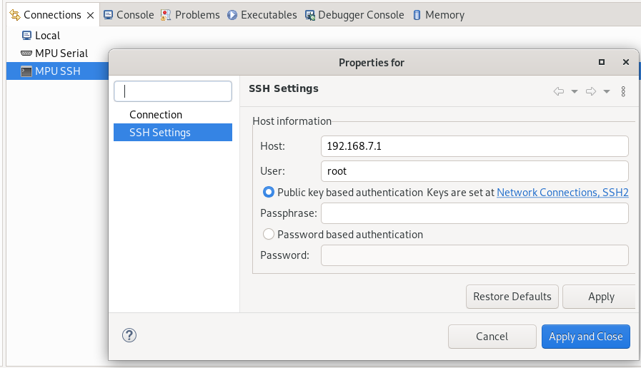

I understand you have updated your target device with sftp-server so you are able to browse it from an xterm of you Linux PC with "sftp root@192.168.7.1".
Could you please open connections inside STM32CubeIDE using menu:
Window > Show View > Otrhers.. Connections > Connections
and check if "MPU SSH" is present
If not please add it, with New Connection icon.
You should be able to open this connection, and Open Command Shell.
Then, you can try to debug production mode.
Hope this help,
LudovicR

2022-02-10 2:02 AM
Hi @MSven.2 ,
I guess your issue is linked to "MPU SSH" connnection not present.
Could you try after setting it up?
LudovicR
