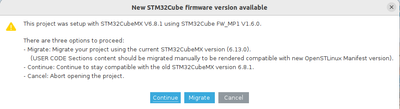

In preparation for this, I regenerated the DTS files using STM32CubeMX_6.13.0 and loaded the existing .ioc file. While regenerating the DTS files using STM32CubeMX_6.1.3 and loading the existing .ioc file, I selected the Migrate option when prompted by the tool. Could you please confirm if this is the correct choice, or would selecting Continue be more appropriate in this case?

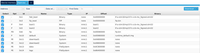

Some additional information on what we flash is as below:
Thought may add some extra information in this context.
