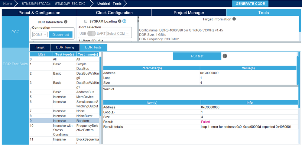

Let me explain what I am doing and I will share a screen shot of the error, it will then give you an idea.
I am using STM32MP157-DK2 board and the SD card which came with it.
I set the boot pins so that it boots from SD card. (boot0=1, boot2=1)
I created a project on STM32CubeMX 6.0.1 for the above board and I Initialize all peripherals with their default Mode
I carried out the test from Tools>DDR TestSuite.
I am able to connect to the board by selecting connect from DDR interactive section. (it is using the SPL from the SD card)
I am able to run all test except test number 9, (Intensive Random)
Please see the attached screen shot

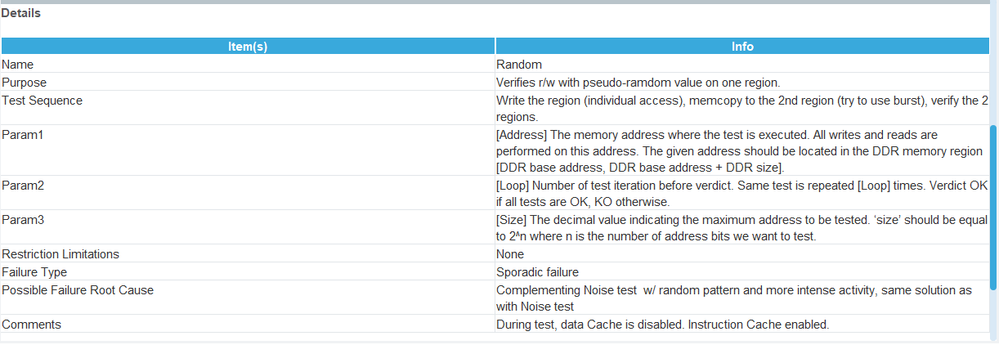

I found more information about the test no 9, see attched schreenshot0693W000004GunbQAC.png

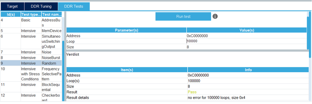

Could you please try to change parameter size to 8 and tell us result please ?
Is failure random or systematic ?
Thx

Hi @BalaGajenthan​
Are you sure your are using STM32CubeMX 6.0.1 ? Because in this last version you are not supposed to be able to set size below 8.
There is known issue in test when size below 8.
Olivier

BalaGajenthan
Associate II
Hi @Community member​
Thanks for the reply.
with size 8, The test always passes,
with regards to the version number, you are right I am running CubeMX 5.6.1. some how I got this wrong.
Could you tell me where these DDR tests are defined? are they part of CubeMX?
Hi @BalaGajenthan​
DDR tests are defined in U-Boot SPL.
CubeMX is just interfacing with U-Boot to launch them and get results.
Olivier
