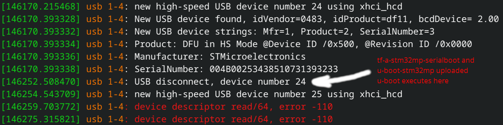

However, when U-Boot is executed, the target board fails to reconnect over USB. Here is the dmesg output:

I have tried everything in the article but I cannot get this to work. The article says it should reconnect as "USB download gadget" after u-boot has been downloaded. This does not happen with our board. Instead, we get error messages:
[ 3752.842604] usb 1-1.1.2: USB disconnect, device number 6
[ 3755.123295] usb 1-1.1.2: new high-speed USB device number 7 using xhci_hcd
[ 3760.411354] usb 1-1.1.2: device descriptor read/64, error -110
[ 3776.027392] usb 1-1.1.2: device descriptor read/64, error -110
[ 3776.223324] usb 1-1.1.2: new high-speed USB device number 8 using xhci_hcd
[ 3781.403408] usb 1-1.1.2: device descriptor read/64, error -110
[ 3797.019881] usb 1-1.1.2: device descriptor read/64, error -110
[ 3797.128891] usb 1-1.1-port2: attempt power cycle
[ 3797.739827] usb 1-1.1.2: new high-speed USB device number 9 using xhci_hcd
[ 3802.540048] usb 1-1.1.2: Device not responding to setup address.
[ 3807.551624] usb 1-1.1.2: Device not responding to setup address.
[ 3807.759839] usb 1-1.1.2: device not accepting address 9, error -71
[ 3807.847440] usb 1-1.1.2: new high-speed USB device number 10 using xhci_hcd
[ 3812.648248] usb 1-1.1.2: Device not responding to setup address.
[ 3817.659847] usb 1-1.1.2: Device not responding to setup address.
[ 3817.867473] usb 1-1.1.2: device not accepting address 10, error -71
[ 3817.869346] usb 1-1.1-port2: unable to enumerate USB device
