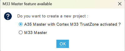

I am working with STM32MP257F1-EV1, I want to ask when creating a project with STM32CubeMx, why my project does not have a file in Secure like other boards?
Thank you.

Hello @Duyvnhd
When creating a project with STM32CubeMX for the STM32MP257F1-EV1, the absence of a Secure folder typically means that TrustZone is not enabled in your project settings. The Secure/Non-Secure folder structure is only generated when TrustZone is activated for the Cortex-M33 core
