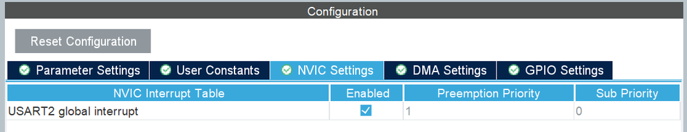

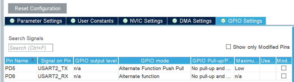

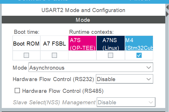

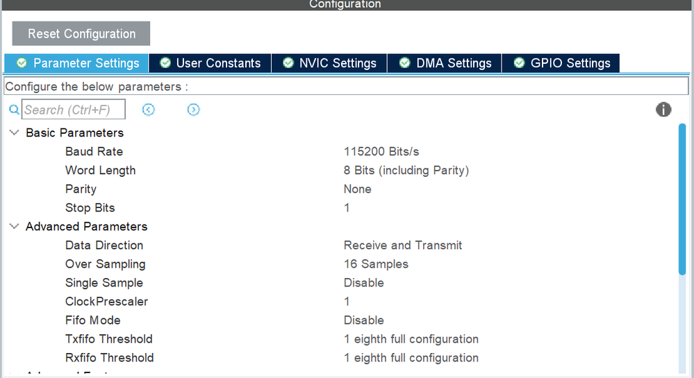

Here is some more information:
0693W00000UnawEQAR.png0693W00000UnawOQAR.png0693W00000UnawTQAR.png0693W00000UnawdQAB.pngI hope it helps
