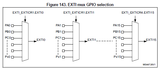

Notice that EXTI can allocate interrupt of only one GPIO pin of same number regardless the GPIO port (see RM abstract below).
So, you cannot define EXTI8 to be from PG8 and PI8 at same time.
You should use another EXTIn channel and another PXn pin for the 2nd interrupt line (with n != 8).

The EXTI controller on STM32 can only select one Pin per Pin number. As you need PG8 and PI8, this does not work. Interrupts on PG8 and PG8 will work as will PG8 and PI9.
