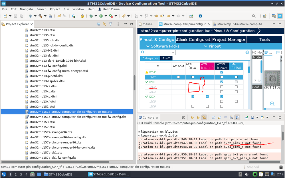

I have installed OpenSTLinux SDK + Sources (linux, tf-a, u-boot, optee-os) on a STM32CubeIDE project.
I have compiled optee-os for my custom board, but it did not work so well for tf-a.
This is clearly a bug because I cannot add "i2c2_pin_a" into the .dts file of stm32mp151-stm32-computer-pin-configuration-mx.dts. If I rename
i2c4_pins_mx -> i2c2_pins_amanually inside the .dts file, then the error disapear when I compile. But I cannot do that in STM32CubeIDE because it does not allow me to add "i2c2" for TF-A.
So is there any walk around for this bug?
23:03:35 **** Build of configuration Default for project stm32-computer-pin-configuration_CA7_tf-a-2.8.15-r2 ****
make -f ../Makefile.sdk.ide TF_A_DEVICETREE=stm32mp151a-stm32-computer-pin-configuration-mx TF_A_CONFIG=optee-sdcard stm32 metadata
Wrapper for /opt/st/stm32cubeide_1.16.0/plugins/com.st.stm32cube.ide.mpu.linux.toolchain_2.1.0.202305092038/tools/bin/make
FIP_DEPLOYDIR_ROOT: /home/lubuntu/Dokument/GitHub/stm32-computer/STM32CubeIDE/stm32-computer-pin-configuration/CA7/tf-a-2.8.15-r2/tf-a-stm32mp-v2.8.15-stm32mp-r2/../../FIP_artifacts
+ case "$command" in
+ exec make -f ../Makefile.sdk.ide TF_A_DEVICETREE=stm32mp151a-stm32-computer-pin-configuration-mx TF_A_CONFIG=optee-sdcard stm32 metadata
make[1]: Nothing to be done for 'all'.
make[1]: Entering directory '/home/lubuntu/Dokument/GitHub/stm32-computer/STM32CubeIDE/stm32-computer-pin-configuration/CA7/tf-a-2.8.15-r2/tf-a-stm32mp-v2.8.15-stm32mp-r2'
Including bl32/optee/optee.mk
Trusted Firmware-A built for OP-TEE payload support
PSA_FWU_SUPPORT is an experimental feature
CPP /home/lubuntu/Dokument/GitHub/stm32-computer/STM32CubeIDE/stm32-computer-pin-configuration/CA7/tf-a-2.8.15-r2/tf-a-stm32mp-v2.8.15-stm32mp-r2/../build/optee-sdcard-stm32mp15-stm32mp151a-stm32-computer-pin-configuration-mx/fdts/stm32mp151a-stm32-computer-pin-configuration-mx-bl2.dts
DTC /home/lubuntu/Dokument/GitHub/stm32-computer/STM32CubeIDE/stm32-computer-pin-configuration/CA7/tf-a-2.8.15-r2/tf-a-stm32mp-v2.8.15-stm32mp-r2/../build/optee-sdcard-stm32mp15-stm32mp151a-stm32-computer-pin-configuration-mx/fdts/stm32mp151a-stm32-computer-pin-configuration-mx-bl2.dts
Error: /home/lubuntu/Dokument/GitHub/stm32-computer/STM32CubeIDE/stm32-computer-pin-configuration/CA7/tf-a-2.8.15-r2/tf-a-stm32mp-v2.8.15-stm32mp-r2/../build/optee-sdcard-stm32mp15-stm32mp151a-stm32-computer-pin-configuration-mx/fdts/stm32mp151a-stm32-computer-pin-configuration-mx-bl2.pre.dts:946.18-29 Label or path fmc_pins_a not found
Error: /home/lubuntu/Dokument/GitHub/stm32-computer/STM32CubeIDE/stm32-computer-pin-configuration/CA7/tf-a-2.8.15-r2/tf-a-stm32mp-v2.8.15-stm32mp-r2/../build/optee-sdcard-stm32mp15-stm32mp151a-stm32-computer-pin-configuration-mx/fdts/stm32mp151a-stm32-computer-pin-configuration-mx-bl2.pre.dts:947.18-30 Label or path i2c2_pins_a not found
make[1]: Leaving directory '/home/lubuntu/Dokument/GitHub/stm32-computer/STM32CubeIDE/stm32-computer-pin-configuration/CA7/tf-a-2.8.15-r2/tf-a-stm32mp-v2.8.15-stm32mp-r2'
Error: /home/lubuntu/Dokument/GitHub/stm32-computer/STM32CubeIDE/stm32-computer-pin-configuration/CA7/tf-a-2.8.15-r2/tf-a-stm32mp-v2.8.15-stm32mp-r2/../build/optee-sdcard-stm32mp15-stm32mp151a-stm32-computer-pin-configuration-mx/fdts/stm32mp151a-stm32-computer-pin-configuration-mx-bl2.pre.dts:948.18-30 Label or path i2c4_pins_a not found
Error: /home/lubuntu/Dokument/GitHub/stm32-computer/STM32CubeIDE/stm32-computer-pin-configuration/CA7/tf-a-2.8.15-r2/tf-a-stm32mp-v2.8.15-stm32mp-r2/../build/optee-sdcard-stm32mp15-stm32mp151a-stm32-computer-pin-configuration-mx/fdts/stm32mp151a-stm32-computer-pin-configuration-mx-bl2.pre.dts:950.18-34 Label or path qspi_bk1_pins_a not found
Error: /home/lubuntu/Dokument/GitHub/stm32-computer/STM32CubeIDE/stm32-computer-pin-configuration/CA7/tf-a-2.8.15-r2/tf-a-stm32mp-v2.8.15-stm32mp-r2/../build/optee-sdcard-stm32mp15-stm32mp151a-stm32-computer-pin-configuration-mx/fdts/stm32mp151a-stm32-computer-pin-configuration-mx-bl2.pre.dts:951.18-34 Label or path qspi_bk2_pins_a not found
Error: /home/lubuntu/Dokument/GitHub/stm32-computer/STM32CubeIDE/stm32-computer-pin-configuration/CA7/tf-a-2.8.15-r2/tf-a-stm32mp-v2.8.15-stm32mp-r2/../build/optee-sdcard-stm32mp15-stm32mp151a-stm32-computer-pin-configuration-mx/fdts/stm32mp151a-stm32-computer-pin-configuration-mx-bl2.pre.dts:952.18-34 Label or path qspi_clk_pins_a not found
Error: /home/lubuntu/Dokument/GitHub/stm32-computer/STM32CubeIDE/stm32-computer-pin-configuration/CA7/tf-a-2.8.15-r2/tf-a-stm32mp-v2.8.15-stm32mp-r2/../build/optee-sdcard-stm32mp15-stm32mp151a-stm32-computer-pin-configuration-mx/fdts/stm32mp151a-stm32-computer-pin-configuration-mx-bl2.pre.dts:953.18-35 Label or path sdmmc1_b4_pins_a not found
Error: /home/lubuntu/Dokument/GitHub/stm32-computer/STM32CubeIDE/stm32-computer-pin-configuration/CA7/tf-a-2.8.15-r2/tf-a-stm32mp-v2.8.15-stm32mp-r2/../build/optee-sdcard-stm32mp15-stm32mp151a-stm32-computer-pin-configuration-mx/fdts/stm32mp151a-stm32-computer-pin-configuration-mx-bl2.pre.dts:954.18-36 Label or path sdmmc1_dir_pins_a not found
Error: /home/lubuntu/Dokument/GitHub/stm32-computer/STM32CubeIDE/stm32-computer-pin-configuration/CA7/tf-a-2.8.15-r2/tf-a-stm32mp-v2.8.15-stm32mp-r2/../build/optee-sdcard-stm32mp15-stm32mp151a-stm32-computer-pin-configuration-mx/fdts/stm32mp151a-stm32-computer-pin-configuration-mx-bl2.pre.dts:955.18-36 Label or path sdmmc1_dir_pins_b not found
Error: /home/lubuntu/Dokument/GitHub/stm32-computer/STM32CubeIDE/stm32-computer-pin-configuration/CA7/tf-a-2.8.15-r2/tf-a-stm32mp-v2.8.15-stm32mp-r2/../build/optee-sdcard-stm32mp15-stm32mp151a-stm32-computer-pin-configuration-mx/fdts/stm32mp151a-stm32-computer-pin-configuration-mx-bl2.pre.dts:956.18-35 Label or path sdmmc2_b4_pins_a not found
Error: /home/lubuntu/Dokument/GitHub/stm32-computer/STM32CubeIDE/stm32-computer-pin-configuration/CA7/tf-a-2.8.15-r2/tf-a-stm32mp-v2.8.15-stm32mp-r2/../build/optee-sdcard-stm32mp15-stm32mp151a-stm32-computer-pin-configuration-mx/fdts/stm32mp151a-stm32-computer-pin-configuration-mx-bl2.pre.dts:957.18-35 Label or path sdmmc2_b4_pins_b not found
Error: /home/lubuntu/Dokument/GitHub/stm32-computer/STM32CubeIDE/stm32-computer-pin-configuration/CA7/tf-a-2.8.15-r2/tf-a-stm32mp-v2.8.15-stm32mp-r2/../build/optee-sdcard-stm32mp15-stm32mp151a-stm32-computer-pin-configuration-mx/fdts/stm32mp151a-stm32-computer-pin-configuration-mx-bl2.pre.dts:958.18-36 Label or path sdmmc2_d47_pins_a not found
Error: /home/lubuntu/Dokument/GitHub/stm32-computer/STM32CubeIDE/stm32-computer-pin-configuration/CA7/tf-a-2.8.15-r2/tf-a-stm32mp-v2.8.15-stm32mp-r2/../build/optee-sdcard-stm32mp15-stm32mp151a-stm32-computer-pin-configuration-mx/fdts/stm32mp151a-stm32-computer-pin-configuration-mx-bl2.pre.dts:959.18-36 Label or path sdmmc2_d47_pins_b not found
Error: /home/lubuntu/Dokument/GitHub/stm32-computer/STM32CubeIDE/stm32-computer-pin-configuration/CA7/tf-a-2.8.15-r2/tf-a-stm32mp-v2.8.15-stm32mp-r2/../build/optee-sdcard-stm32mp15-stm32mp151a-stm32-computer-pin-configuration-mx/fdts/stm32mp151a-stm32-computer-pin-configuration-mx-bl2.pre.dts:960.18-36 Label or path sdmmc2_d47_pins_c not found
Error: /home/lubuntu/Dokument/GitHub/stm32-computer/STM32CubeIDE/stm32-computer-pin-configuration/CA7/tf-a-2.8.15-r2/tf-a-stm32mp-v2.8.15-stm32mp-r2/../build/optee-sdcard-stm32mp15-stm32mp151a-stm32-computer-pin-configuration-mx/fdts/stm32mp151a-stm32-computer-pin-configuration-mx-bl2.pre.dts:961.18-36 Label or path sdmmc2_d47_pins_d not found
Error: /home/lubuntu/Dokument/GitHub/stm32-computer/STM32CubeIDE/stm32-computer-pin-configuration/CA7/tf-a-2.8.15-r2/tf-a-stm32mp-v2.8.15-stm32mp-r2/../build/optee-sdcard-stm32mp15-stm32mp151a-stm32-computer-pin-configuration-mx/fdts/stm32mp151a-stm32-computer-pin-configuration-mx-bl2.pre.dts:963.18-31 Label or path uart4_pins_a not found
Error: /home/lubuntu/Dokument/GitHub/stm32-computer/STM32CubeIDE/stm32-computer-pin-configuration/CA7/tf-a-2.8.15-r2/tf-a-stm32mp-v2.8.15-stm32mp-r2/../build/optee-sdcard-stm32mp15-stm32mp151a-stm32-computer-pin-configuration-mx/fdts/stm32mp151a-stm32-computer-pin-configuration-mx-bl2.pre.dts:964.18-31 Label or path uart4_pins_b not found
Error: /home/lubuntu/Dokument/GitHub/stm32-computer/STM32CubeIDE/stm32-computer-pin-configuration/CA7/tf-a-2.8.15-r2/tf-a-stm32mp-v2.8.15-stm32mp-r2/../build/optee-sdcard-stm32mp15-stm32mp151a-stm32-computer-pin-configuration-mx/fdts/stm32mp151a-stm32-computer-pin-configuration-mx-bl2.pre.dts:965.18-31 Label or path uart7_pins_a not found
Error: /home/lubuntu/Dokument/GitHub/stm32-computer/STM32CubeIDE/stm32-computer-pin-configuration/CA7/tf-a-2.8.15-r2/tf-a-stm32mp-v2.8.15-stm32mp-r2/../build/optee-sdcard-stm32mp15-stm32mp151a-stm32-computer-pin-configuration-mx/fdts/stm32mp151a-stm32-computer-pin-configuration-mx-bl2.pre.dts:966.18-31 Label or path uart7_pins_b not found
Error: /home/lubuntu/Dokument/GitHub/stm32-computer/STM32CubeIDE/stm32-computer-pin-configuration/CA7/tf-a-2.8.15-r2/tf-a-stm32mp-v2.8.15-stm32mp-r2/../build/optee-sdcard-stm32mp15-stm32mp151a-stm32-computer-pin-configuration-mx/fdts/stm32mp151a-stm32-computer-pin-configuration-mx-bl2.pre.dts:967.18-31 Label or path uart7_pins_c not found
Error: /home/lubuntu/Dokument/GitHub/stm32-computer/STM32CubeIDE/stm32-computer-pin-configuration/CA7/tf-a-2.8.15-r2/tf-a-stm32mp-v2.8.15-stm32mp-r2/../build/optee-sdcard-stm32mp15-stm32mp151a-stm32-computer-pin-configuration-mx/fdts/stm32mp151a-stm32-computer-pin-configuration-mx-bl2.pre.dts:968.18-31 Label or path uart8_pins_a not found
Error: /home/lubuntu/Dokument/GitHub/stm32-computer/STM32CubeIDE/stm32-computer-pin-configuration/CA7/tf-a-2.8.15-r2/tf-a-stm32mp-v2.8.15-stm32mp-r2/../build/optee-sdcard-stm32mp15-stm32mp151a-stm32-computer-pin-configuration-mx/fdts/stm32mp151a-stm32-computer-pin-configuration-mx-bl2.pre.dts:969.18-32 Label or path usart2_pins_a not found
Error: /home/lubuntu/Dokument/GitHub/stm32-computer/STM32CubeIDE/stm32-computer-pin-configuration/CA7/tf-a-2.8.15-r2/tf-a-stm32mp-v2.8.15-stm32mp-r2/../build/optee-sdcard-stm32mp15-stm32mp151a-stm32-computer-pin-configuration-mx/fdts/stm32mp151a-stm32-computer-pin-configuration-mx-bl2.pre.dts:970.18-32 Label or path usart2_pins_b not found
Error: /home/lubuntu/Dokument/GitHub/stm32-computer/STM32CubeIDE/stm32-computer-pin-configuration/CA7/tf-a-2.8.15-r2/tf-a-stm32mp-v2.8.15-stm32mp-r2/../build/optee-sdcard-stm32mp15-stm32mp151a-stm32-computer-pin-configuration-mx/fdts/stm32mp151a-stm32-computer-pin-configuration-mx-bl2.pre.dts:971.18-32 Label or path usart2_pins_c not found
Error: /home/lubuntu/Dokument/GitHub/stm32-computer/STM32CubeIDE/stm32-computer-pin-configuration/CA7/tf-a-2.8.15-r2/tf-a-stm32mp-v2.8.15-stm32mp-r2/../build/optee-sdcard-stm32mp15-stm32mp151a-stm32-computer-pin-configuration-mx/fdts/stm32mp151a-stm32-computer-pin-configuration-mx-bl2.pre.dts:972.18-32 Label or path usart3_pins_a not found
Error: /home/lubuntu/Dokument/GitHub/stm32-computer/STM32CubeIDE/stm32-computer-pin-configuration/CA7/tf-a-2.8.15-r2/tf-a-stm32mp-v2.8.15-stm32mp-r2/../build/optee-sdcard-stm32mp15-stm32mp151a-stm32-computer-pin-configuration-mx/fdts/stm32mp151a-stm32-computer-pin-configuration-mx-bl2.pre.dts:973.18-32 Label or path usart3_pins_b not found
Error: /home/lubuntu/Dokument/GitHub/stm32-computer/STM32CubeIDE/stm32-computer-pin-configuration/CA7/tf-a-2.8.15-r2/tf-a-stm32mp-v2.8.15-stm32mp-r2/../build/optee-sdcard-stm32mp15-stm32mp151a-stm32-computer-pin-configuration-mx/fdts/stm32mp151a-stm32-computer-pin-configuration-mx-bl2.pre.dts:974.18-32 Label or path usart3_pins_c not found
Error: /home/lubuntu/Dokument/GitHub/stm32-computer/STM32CubeIDE/stm32-computer-pin-configuration/CA7/tf-a-2.8.15-r2/tf-a-stm32mp-v2.8.15-stm32mp-r2/../build/optee-sdcard-stm32mp15-stm32mp151a-stm32-computer-pin-configuration-mx/fdts/stm32mp151a-stm32-computer-pin-configuration-mx-bl2.pre.dts:975.18-41 Label or path usbotg_fs_dp_dm_pins_a not found
Error: /home/lubuntu/Dokument/GitHub/stm32-computer/STM32CubeIDE/stm32-computer-pin-configuration/CA7/tf-a-2.8.15-r2/tf-a-stm32mp-v2.8.15-stm32mp-r2/../build/optee-sdcard-stm32mp15-stm32mp151a-stm32-computer-pin-configuration-mx/fdts/stm32mp151a-stm32-computer-pin-configuration-mx-bl2.pre.dts:976.18-35 Label or path usbotg_hs_pins_a not found
FATAL ERROR: Syntax error parsing input tree
make[1]: *** [Makefile:1453: /home/lubuntu/Dokument/GitHub/stm32-computer/STM32CubeIDE/stm32-computer-pin-configuration/CA7/tf-a-2.8.15-r2/tf-a-stm32mp-v2.8.15-stm32mp-r2/../build/optee-sdcard-stm32mp15-stm32mp151a-stm32-computer-pin-configuration-mx/fdts/stm32mp151a-stm32-computer-pin-configuration-mx-bl2.dtb] Error 1
make: *** [../Makefile.sdk:232: tf-optee-sdcard-stm32mp15] Error 1
"make -f ../Makefile.sdk.ide TF_A_DEVICETREE=stm32mp151a-stm32-computer-pin-configuration-mx TF_A_CONFIG=optee-sdcard stm32 metadata" terminated with exit code 2. Build might be incomplete.
23:03:37 Build Failed. 31 errors, 0 warnings. (took 1s.745ms)

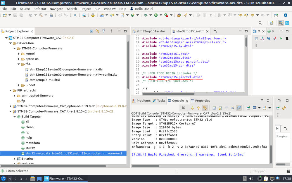

2024-07-31 7:04 AM - edited 2024-08-03 8:45 AM
Hi!
I found the solution. You MUST add #include "stm32mp-pinctrl.dtsi" here.
Hi!
2024-10-10 6:07 AM - edited 2024-10-10 6:09 AM
You just saved me a lot of time. Thanks!
To anyone else following along - the file to edit is (in the case of the stm32mp153d)
stm32mp153d-stm32mp153d_initial-mx.dts
