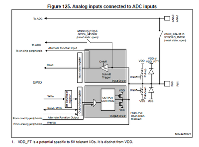

When the board is first turned on and the firmware on the M4 is started the readings of the 11 inputs are correct and consistently follow the changes to the inputs. After a subsequent Stop and Restart of the M4 firmware, one of the inputs on ADC1 (IN16 Rank 6 PA0) also appears influenced by the value present on another ADC1 input (IN0 Rank 4 ANA0). That is, both values present in PA0 and ANA0 contribute proportionally to the adc value read of the PA0 input, while all the other inputs (including ANA0) work correctly.

Have you ensure you did not touch the SYSCFG_PMCSETR bits 24 and 25 ?
Regards
Tip of the day: Try Sidekick STM32 AI agent, see here
Hi @PatrickF,
the problem of the interference of the readings was due to an incorrect initialization of SYSCFG_PMCSETR as you highlighted, thank you for the assistance provided.
CubeMx had correctly composed the right initialization of this register which predicts the open state of these switches
HAL_SYSCFG_AnalogSwitchConfig(SYSCFG_SWITCH_PA0, SYSCFG_SWITCH_PA0_OPEN);
HAL_SYSCFG_AnalogSwitchConfig(SYSCFG_SWITCH_PA1, SYSCFG_SWITCH_PA1_OPEN);
void HAL_SYSCFG_AnalogSwitchConfig(uint32_t SYSCFG_AnalogSwitch , uint32_t SYSCFG_SwitchState )
  /* Check the parameter */
  assert_param(IS_SYSCFG_ANALOG_SWITCH(SYSCFG_AnalogSwitch));
  assert_param(IS_SYSCFG_SWITCH_STATE(SYSCFG_SwitchState));
  SYSCFG->PMCCLRR = SYSCFG_AnalogSwitch;
  SYSCFG->PMCSETR = (uint32_t)(SYSCFG_SwitchState);
But the problem arises from an inversion of the definitions of SYSCFG_SWITCH_PAx_OPEN and SYSCFG_SWITCH_PAx_CLOSE present in STM32MP1xx_HAL_Driver/Inc/stm32mp1xx_hal.h
#define SYSCFG_PMCSETR_ANA0_SEL_Pos (24U)
#define SYSCFG_PMCSETR_ANA0_SEL_Msk (0x1UL << SYSCFG_PMCSETR_ANA0_SEL_Pos)
#define SYSCFG_PMCSETR_ANA0_SEL_SEL SYSCFG_PMCSETR_ANA0_SEL_Msk
#define SYSCFG_PMCSETR_ANA1_SEL_Pos (25U)
#define SYSCFG_PMCSETR_ANA1_SEL_Msk (0x1UL << SYSCFG_PMCSETR_ANA1_SEL_Pos)
#define SYSCFG_PMCSETR_ANA1_SEL_SEL SYSCFG_PMCSETR_ANA1_SEL_Msk
#define SYSCFG_SWITCH_PA0 SYSCFG_PMCSETR_ANA0_SEL_SEL  /*!< Select PA0 analog switch */
#define SYSCFG_SWITCH_PA1 SYSCFG_PMCSETR_ANA1_SEL_SEL  /*!< Select PA1 analog switch */
#define SYSCFG_SWITCH_PA0_OPEN SYSCFG_PMCSETR_ANA0_SEL_SEL /*!< PA0 switch opened */
#define SYSCFG_SWITCH_PA0_CLOSE (uint32_t)0x00000000) /*!< PA0 switch closed */
#define SYSCFG_SWITCH_PA1_OPEN SYSCFG_PMCSETR_ANA1_SEL_SEL /*!< PA1 switch opened */
#define SYSCFG_SWITCH_PA1_CLOSE ((uint32_t)0x00000000) /*!< PA1 switch closed*/
By switching the opening of these switches again after the incorrect configuration, the problem was solved! Analog readings are correct even following consecutive Stop/Starts of the M4 firmware.
