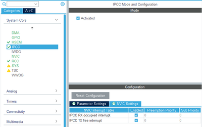

2024-09-17 2:30 AM
It seems that the IPCC interrupts are note activated on your IOC file making the communication impossible between M0/M4, the stack will then return an error and the traces will not be displayed.
Please activate the IPCC Tx and Rx interrupts as follow
Best regards,
