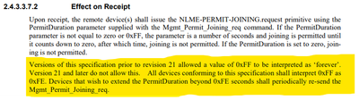

According to Zigbee specification paragraph 3.6.1.2 referring to to the NLME-PERMIT-JOINING.request procedure:
When this procedure is initiated with the PermitDuration parameter set to a value between 0x01 and 0xfe, the NLME shall set the macAssociationPermit PIB attribute in the MAC sub-layer to TRUE. The NLME shall then start a timer to expire after the specified duration. On expiration of this timer, the NLME shall set the macAssociation-Permit PIB attribute in the MAC sub-layer to FALSE
When this procedure is initiated with the PermitDuration parameter set to 0xff, the NLME shall set the macAssociationPermit PIB attribute in the MAC sub-layer to TRUE for an unlimited amount of time, unless another NLME-PERMIT-JOINING.request primitive is issued.

Hello @tcpctrnk,
The valid range of PermitDuration is [0x00 : 0xFE]
The value 0x00 indicate that permission is disabled, other value between 0x01 and 0xFE is the amount of time in second to allow the join.
The Permit duration value of 0xFF has been removed starting from Zigbee R21 version.
Kind regards,
Ouadi
