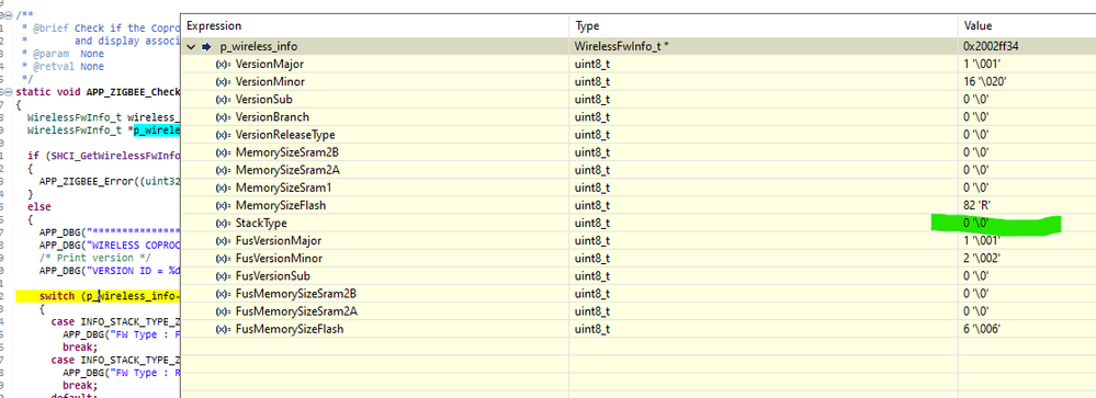

Hi, I'm trying to start the zigbee on Nucleo-WB55.
After upgrading the FUS to 1.2.0.0 and Stack to 1.16.0.0 without any problem,
I get an issue in the running code when it checks the "StackType",
it should be 48 or 49 but it returns 0:
Tested with two different examples on two boards...
What can I check?
Thank you,
Pierre

Ensure that the wireless stack is running on CPU2, if the FUS is running the value Stack Type will be at 0.
