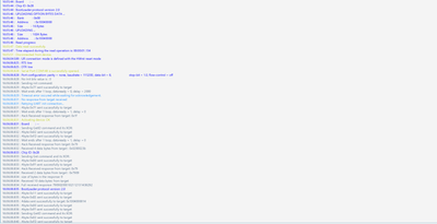

2025-06-02 6:01 AM
I should have mentioned that i already try in STM32CubeProgrammer.
Yes I use PA1 and PB0 which from what I see on schematic for shield is available on the arduino pins.
Serial is set to 8-bit no parity, 9600 bps and 115200 are tried.
I have attached the logs
14:55:35:651 : UR connection mode is defined with the HWrst reset mode
14:55:35:661 : RTS low
14:55:35:661 : DTR low
14:55:35:674 : Serial Port COM5 is successfully opened.
14:55:35:674 : Port configuration: parity = none, baudrate = 115200, data-bit = 8, stop-bit = 1.0, flow-control = off
14:55:35:674 : No Init bits value is : 0
14:55:35:674 : Sending init command:
14:55:35:676 : #byte 0x7F sent successfully to target
14:55:37:677 : Wait ends after 1 loop, dataready = 0, delay = 2000
14:55:37:677 : Timeout error occured while waiting for acknowledgement.
14:55:37:678 : No response from target received
14:55:37:678 : Retrying UART init connection...
14:55:37:680 : #byte 0x7F sent successfully to target
14:55:37:778 : Wait ends after 1 loop, dataready = 0, delay = 100
14:55:37:779 : Timeout error occured while waiting for acknowledgement.
14:55:37:781 : No response from target received
14:55:37:781 : Error: Activating device: KO. Please, verify the boot mode configuration and check the serial port configuration. Reset your device then try again...
14:55:37:894 : UART PORT CLOSE
