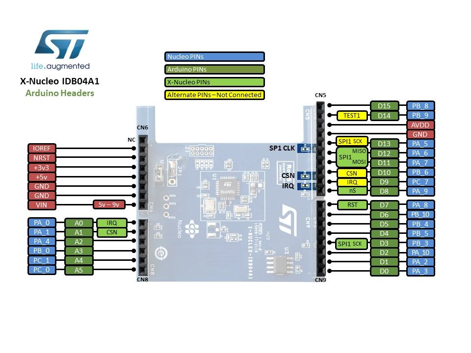

The problem is now solved. I was using the Nucleo Expansion Board with a black pill module with necessary connections (In the image attached). I ordered a nucleo board and hooked up the expansion board with it. And it worked like a charm. Seems like in order to use it with the black pill module, I need to do something extra for a reliable connection. Do you happen to know what extra connections I need to consider?

Reference documentation to use is the one for X-CUBE-BLE2 package ( which apply to X-NUCLEO-BNRG2A1) . I attached it to this post. This doc describe how to configure both SW and Nucleo HW.
Please take care that the screen copy you attached on your last post is a different board (IDB04A1) which must be used together with X-CUBE-BLE1 package. Slightly different from the one we are discussing here
