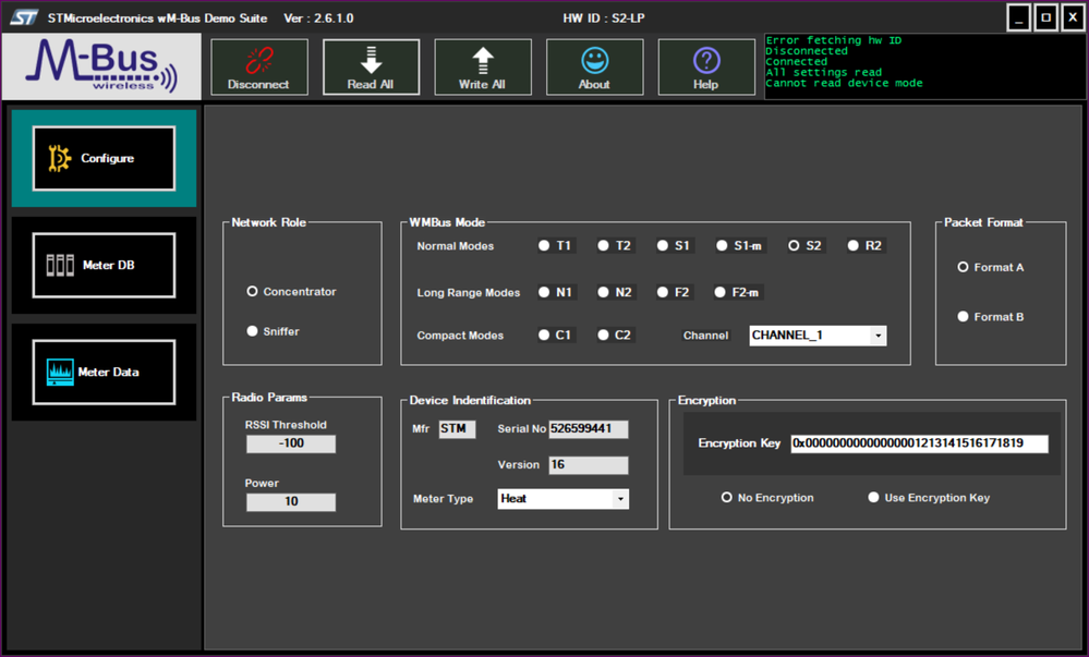

I can click connect in the GUI and it works.
I can click on "Read All" once, it usually works (not all the time):
The if I try to click again it or do anything else like writing settings it just stops working:

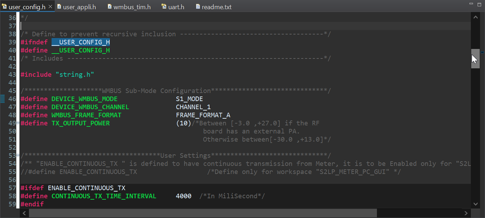

Here the mode is also set to S2 (it's the default setting in user_config.h) but even if i try to change it to for example S1 like so:
Nothing changes. I don't even know which modes you can actually set because I couldn't find any enum or information about it...
I would juste like to be able to put it in sniffer mode and maybe try different WMBus Modes like C1 or T1.
